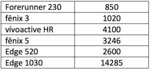

Some devices are slower, and some are faster. The Tree benchmark that is available to download on Connect IQ Store is very useful for developers. In the application description, you can see the list of devices and how they perform (higher number is better). For example, the vívoactive HR is slightly better than fēnix 5, because it has a lower display resolution and it needs to draw less pixels.
