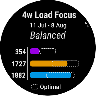

If you are already familiar with the Load Focus screen in the Training Status widget, you will probably notice that these runs map neatly onto the Anaerobic, Low Aerobic and High Aerobic bars that help guide your Training Load toward the right balance.

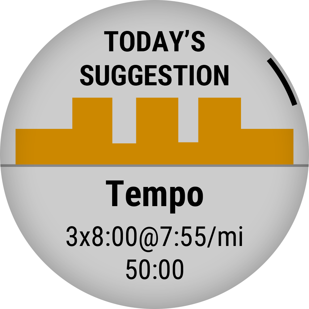

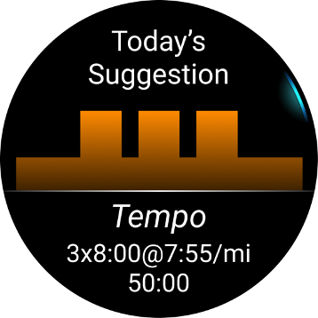

Tempo
Tempo runs are where things start to pick up speed and feel more like actual running. You need to put in some effort to keep up the pace but can keep going for a while if you want to go for it.
Performed at your so-called marathon pace, the target intensity for your tempo runs is sandwiched in between your endurance runs and threshold runs. These runs can be suggested as either steady-pace workouts or take the form of relatively gentle interval runs, where the harder segments are longer and performed with an intensity well below an all-out sprint.
Tempo runs are a terrific way to build general fitness and contribute nicely to the high-intensity aerobic bar on your Training Load Focus screen in the Training Status widget.

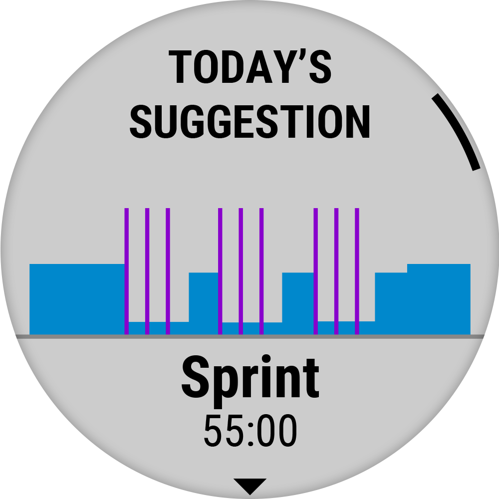

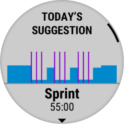

Sprint
The final category of training runs included in this system are built around the most explosive efforts you can perform. The extreme nature of these forces means that you can’t sustain them for very long … and that’s the point. This is your opportunity to go all out, leaving it all on the road.
Quickly summoning this amount of power from your muscles has a remarkable effect. It improves the ability of your nerves and muscles to work together. This includes developing the sequencing and coordination of muscle contractions and recruiting more muscle fiber units into the movement. These elements translate into your ability to generate higher top speeds.
These adaptations fall under the category of neuromuscular power and can have a tremendous impact on your overall performance, especially in racing and general sports performance. Working to increase top speed can also improve your race-pace running economy.
Sprint training is most beneficial when you are well rested and ready to be at your best. This means, you shouldn’t expect to see these workouts suggested if you have a significant amount of recovery time remaining due to a hard training session the day before or a bad night’s sleep.
Adequate recovery between runs is always important, but it is especially important here. Pushing your limits while fatigued opens the door to injury. It also means likely missing out on the full developmental benefit of your efforts because your body will struggle to bounce back instead of getting stronger.
