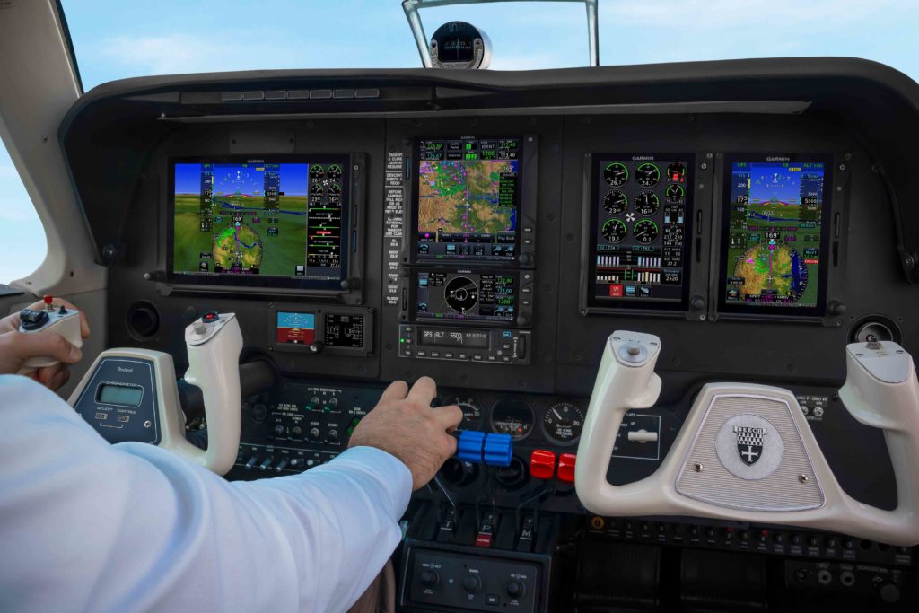

Pilot flying airplane with hand on yoke and throttle, Smart Rudder Bias active
Smart Rudder Bias available with Garmin GFC 600.

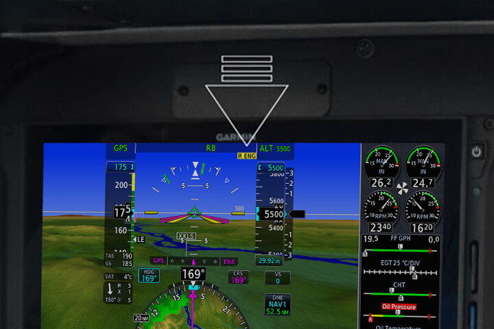

When the aircraft reaches the manufacturer’s published minimum control speed (VMC) during the takeoff roll, Smart Rudder Bias is automatically armed. Smart Rudder Bias continuously monitors engine parameters using Engine Indication System (EIS) data displayed on a G500 TXi or G600 TXi flight display and activates when the system detects a predetermined power differential between each engine. Once activated, rudder force is dynamically adjusted to aid a pilot in providing enough force to the rudder to help control a sideslip. A yellow annunciator for the associated inoperative engine is conveniently displayed along with autopilot annunciations on the G500 TXi or G600 TXi flight display, helping the pilot identify the issue quicker. Smart Rudder Bias can be deactivated via a panel-mounted switch.
Arrow identifying the yellow annunciator on G500 TXi and G600 TXi that helps identify the inoperative engine quicker
A yellow annunciator for the associated inoperative engine is conveniently displayed on the Garmin G500 TXi or G600 TXi flight display.
