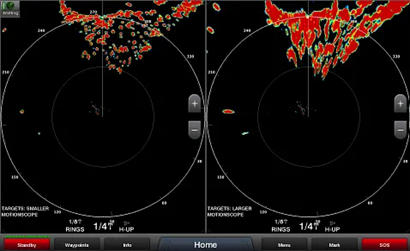

Target size: Adjust target size for better separation on your screen.
Radar imagery showing target size differences (left being small and right being large)

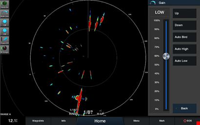

Dynamic auto gain: The dynamic auto gain feature will automatically adjust your gain to filter out noise from environmental factors. You can also manually adjust the gain with a higher gain giving you a longer but narrower view. Lower gain will have shorter reach but allows you to see more of your surrounding view.
Radar imagery showing gain control with manual slider

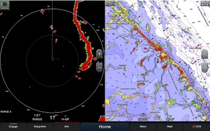

Dual range with overlay: The dual range with overlay feature shows split-screen images for both close and long range. Plus, dual range capabilities support chart overlay, so you can layer radar images on top of your navigation chart.
Radar imagery showing dual range with chart overlay

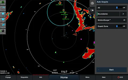

MARPA target tracking: This feature allows you to track up to 30 nearby targets. When you’ve selected a target to track, it will appear with a green ring around it and a dashed green line indicating its projected target and GPS heading. When a target gets within range of your vessel, a red ring, alarm and message banner will notify you so you can change your course.
Radar imagery showing four acquired MARPA targets

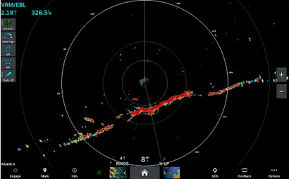

Alerts and markers: To help avoid potential collisions, variable range markers (VRM) and electronic bearing lines (EBL) give distance and bearing to vessels and land structures. Once you’ve set the desired zone around your vessel, you’ll receive an alert when you move too close.
Radar imagery showing VRM and EBL control
