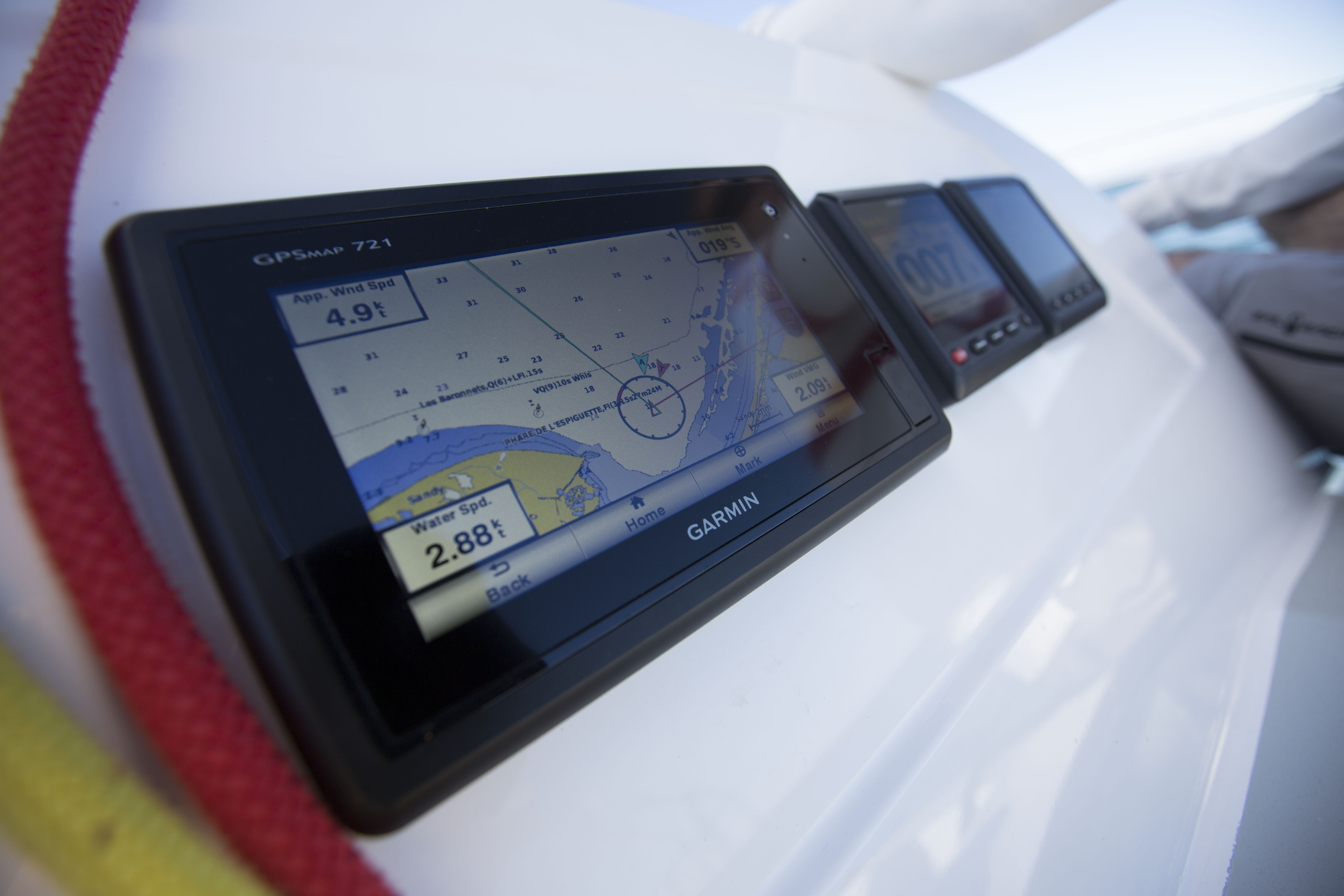

3. Removing Electronics – If possible, remove those electronics. In some boats, this isn't an option but if it is, bring them inside for those winter months. Safely storing your GPS in the home is significantly better than leaving it outside. Although the units are tested to withstand extremely cold temperatures, being in a controlled climate and environment is ideal. Also, it's a good idea to document the wiring so you feel confident about re-installing. Our units are intuitive and use colour-coding for installation, but it's never a bad idea to write it down, just in case.
If your GPS can't be removed, make sure to put the cover over the screen. This sounds trivial but it really is important for preserving your device. This greatly reduces any temperature damage that can be incurred and is easy to do. Any type of soft, anti-abrasive and anti-static padding or insulation can also be used.
