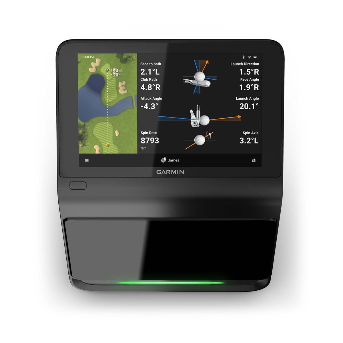

The Approach R50 launch monitor uses three high-speed cameras to track more than 15 ball and club2 metrics, such as spin rate and spin axis. These cameras allow R50 to provide precision analytics for each of your clubs (including drivers) as well as high-speed impact videos so you can review your moment of contact for each shot.

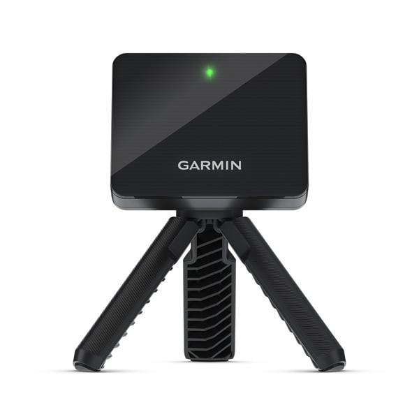

Approach R10 uses radar to provide more than 15 ball and club metrics. You can see your stats on the Garmin Golf™ app on your compatible smartphone between swings3. Plus, you can record and analyze your own swing with video clips that feature your real stats overlaid on each shot. With a Garmin Golf membership, those videos can be stored in the cloud so you can review them later and track how your swing changes over time.

Radar-based launch monitors transmit radio waves that bounce off objects and return to the radar receiver. The frequency created by those radio waves is used to measure the speed and direction of a moving object. Radar-based launch monitors track a longer flight of the golf ball, making them well-suited for outdoor use where there is ample space.

Club measurements: Approach R50 requires a sticker and measures the speed and path of that point on the club face, while Approach R10 measures these at the club’s head (which gives the strongest return signal).

But with Approach R50, you don’t need anything else to hit the course. The built-in 10” color touchscreen display serves as a simulator by itself. No need to worry about buying a separate gaming computer to use the simulator — everything you need is already there. So you can get a tee time, anytime.
Want the ultimate simulator experience? Simply connect your monitor or projector to the HDMI output on Approach R50, and you can transform your garage or basement into your favorite virtual course. You can even customize the set up to fit your needs. For example, display the Home Tee Hero on your projector, but check your launch monitor data or impact videos on the Approach R50 display. With Home Tee Hero, you can even putt with Approach R50.

If you want to use your launch monitor inside and outside, you may prefer Approach R50 because the cameras measure metrics within a small area around impact and aren’t susceptible to environmental conditions such as wind. Approach R50 can go from the golf course to your indoor setup easily with the included carrying case, so rainy days won’t get in the way of your tee time. It’s compatible with every club, including putters, and provides up to 4 hours of battery life. Approach R50 also requires less space to set up indoors compared to Approach R10 because the radar-based launch monitor needs to be behind you.
Approach R10, which can fit in your bag, is a great option for outdoor use because it isn’t inhibited by an impact screen or net that you would use indoors. Approach R10, also lightweight and portable, offers up to 10 hours of battery life.
